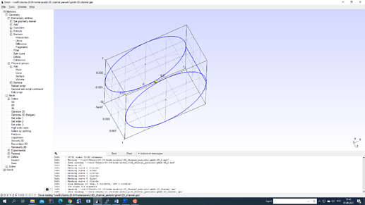

I have tube R=1:
I solve Navie-stoks equation and get u field.

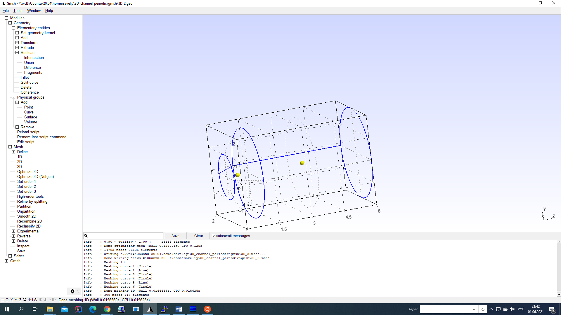

I want to take a field from the section z = 1 and solve a problem with a different geometry:
R=1 the radus are the same
