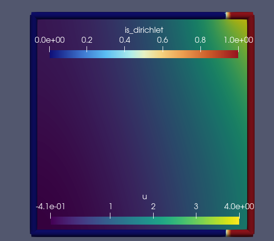

You don’t need to generate the weak forms again at each time step, but you would need to modify the list of boundary conditions on each time step.
Here is an illustration using an indicator function:

First time solving:
After update
Of course, if we now use a g that is different than the analytical g, we will clearly see the effect on the solution. For instance, using: g = ufl.sin(x[0]) * ufl.cos(x[1] * ufl.pi):
