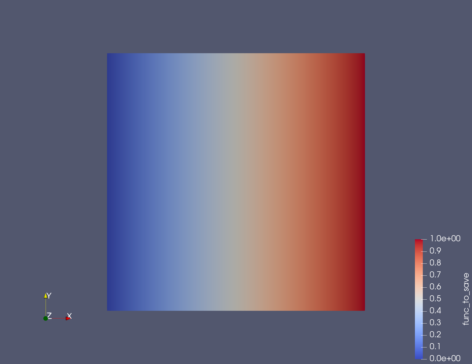

xdmf_2 = XDMFFile(mpi4py.MPI.COMM_WORLD, "solution_out.xdmf")
xdmf_2.write_checkpoint(f, 'func_to_save', 0, append=False)
xdmf_2.close()
