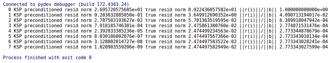

But I got the below weird result.
  1. Use solver.set_operators(A, P),
    For this iteration, why would it stop? I mean I set relative tolerance to 1E-10 and absolute tolerance to 1E-12.
  2. Use solver.set_operator(A),
    For this iteration, it’s more absurd. I cannot understand at all.
The results are “correct” since fenics / petsc uses the preconditioned residual in order to check the convergence criterion. Also, the petsc faq says that this discrepancy can happen, e.g., for saddle point problems: https://www.mcs.anl.gov/petsc/documentation/faq.html#kspdiverged
You could circumvent this by applying the preconditioner from the right hand side, since you will then always have an unpreconditioned norm in your convergence check. A MWE could look like this:
