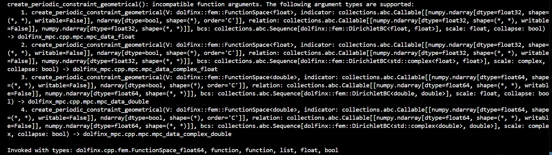

I am trying to implement periodic boundary conditions for 3D TGV using dolfinx_mpc. But, I am having some type errors.
My dolfinx and dolfinx_mpc versions are as following:
The code I am using is as following:

except Exception as e:
print(f"\nAn unexpected error occurred: {e}")
The below is the error message:
Does anyone have similar issues?
