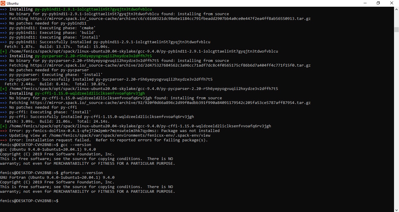

I have installed BLAS using $sudo apt install libopenblas-dev and I have also installed GCC and gfortran compiler.
fenics@DESKTOP-CVH2BNB:~$ gcc --version
gcc (Ubuntu 9.4.0-1ubuntu1~20.04.1) 9.4.0
fenics@DESKTOP-CVH2BNB:~$ gfortran --version
GNU Fortran (Ubuntu 9.4.0-1ubuntu1~20.04.1) 9.4.0

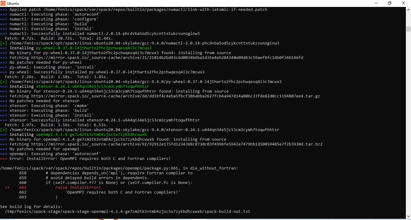

When I run $ spack install, I get below stack details with error:
I am unable to post the output here (because of the word limit). So I am attaching the output in a jpeg image format. I am allowed to attach 5 images with this message. So I am attaching the output image in jpeg (only the error portions of the output) in a chronological order.
It looks like spack is not aware of your gfortran installation. Maybe you installed gfortran after creating the spack environment?
Can you try running the following command
spack compiler find
this will force a scan of all available compilers.

That’s weird. Not sure why spack is unable to find your fortran compiler.
Not 100% sure it’s gonna help, but you can try editing the /home/fenics/.spack/linux/compilers.yaml file manually into something like this:
spec: gcc@9.4.0:
paths:
    cc = /usr/bin/gcc
    cxx = /usr/bin/g++
    f77 = /usr/bin/gfortran
    fc = /usr/bin/gfortran

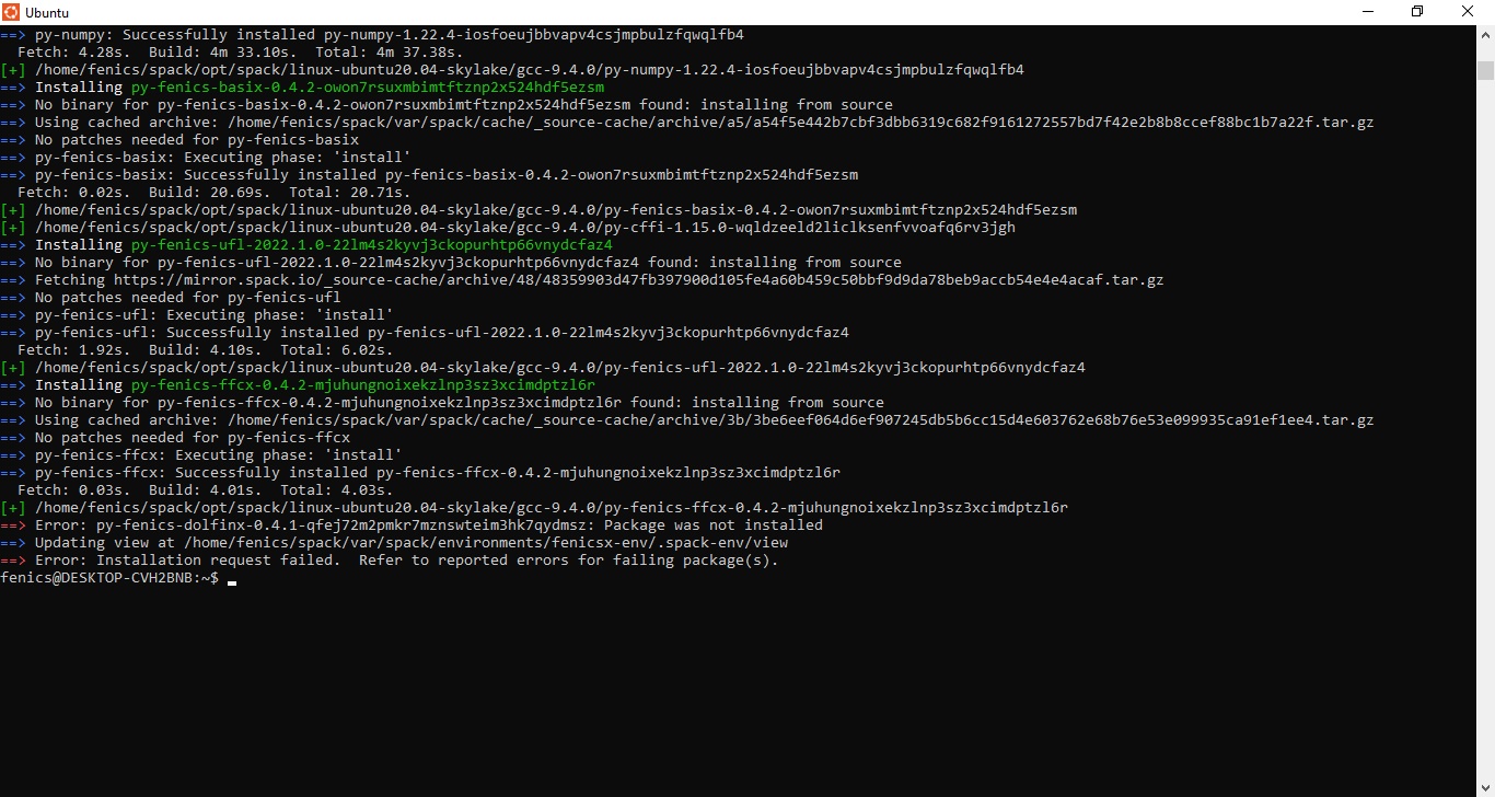

After updating /home/fenics/.spack/linux/compilers.yaml file manually as you said, the finding compilers error has been solved. Now the new error comes. I have attached the screenshot showing error with this mail. Please help.
Not sure about this one. Looks like a download error to me but I do not know how to fix it.
Maybe somebody else has an idea.
