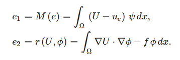

When I am trying to calculate the difference between two types of error, I’m not receiving numerical results (I’m looking for a number, and getting back math). I’m pretty new to FEniCS, so I don’t know how to get around this.
What I’m looking to obtain are the following:
Where Omega is a unit square.

e1 = ((U - ue)*psi)*dx
e2 = (inner(grad(U), grad(phi)) - f*phi)*dx
