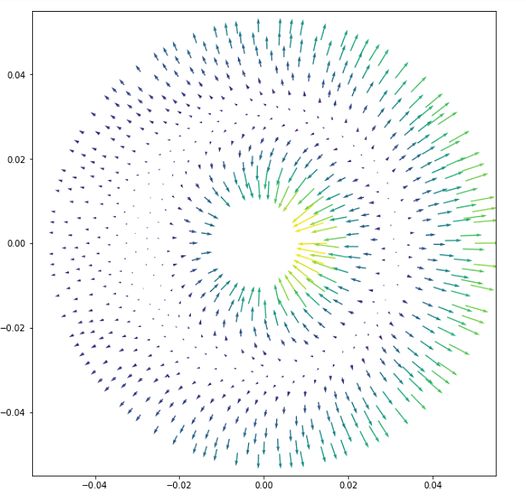

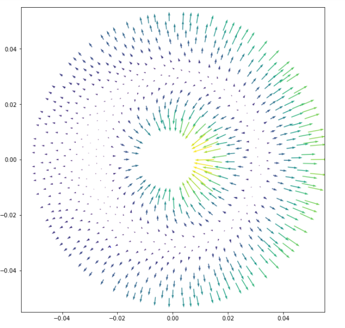

I have a velocity field V
on an annulus. It might look like this:
If you propagate a particle with this velocity field, it is quickly transpored to one of the two border components of the annulus (e.g. hole in the middle or the outer circle).
