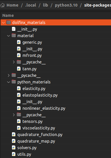

Here are my dolfinx site-packages, where it is clear that the scripts seen from the error above are not present:
Is this still an error with my installation? Any help would be much appreciated!
