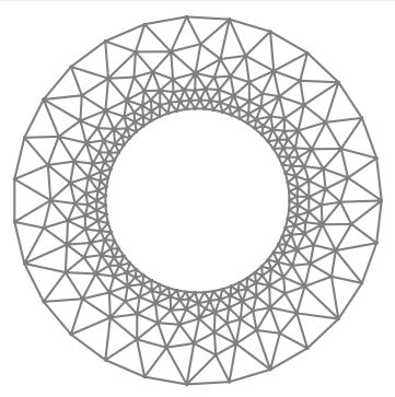

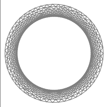

This produces, for an annulus mesh:
Schermata da 2022-07-09 18-11-34
Schermata da 2022-07-15 18-50-52
What remains to be defined is an independent spherical mesh, set up g on there, and then evaluate g(x/|x|), where x is taken from the original mesh. Is there any way these steps can be accomplished, compatibly with dolfin-adjoint? We can suppose I have my spherical mesh already.
