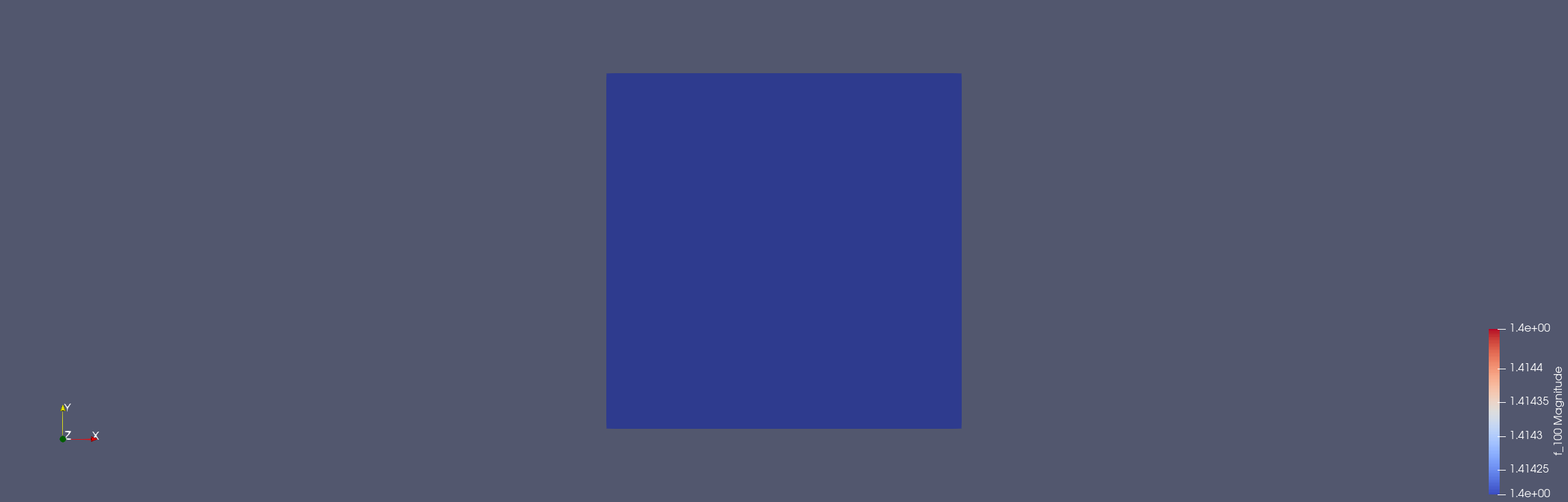

, I see that omega_n
and omega_n_1
are both equal to the vector (1,1), while omega_n_12
, which has been defined as their average in omega_n_12 = (omega_n + omega_n_1) / 2.0
, is equal to (1/2,1/2) (so it differs from their average!), see screenshots attached.
