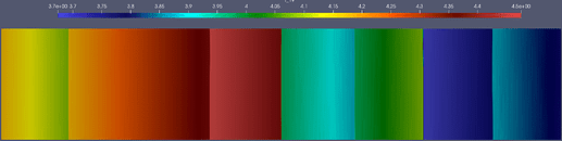

However, when I work with the split functions, I realized that the data is disorganized.
This is what I get:
Figure 1
This is what I was expecting:
Figure 2
I guess this is due to parallel computing, although I would expect eight partitions and not seven. In any case, there is a problem storing this data for later reuse.
