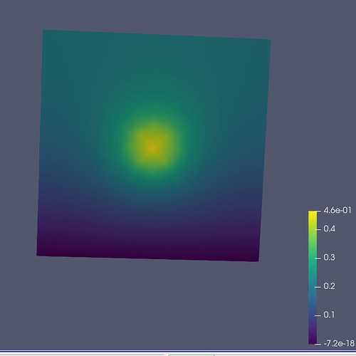

I’m not sure what solution you are expecting.
This is what I get after one time step:
12 time steps:
75 time steps:

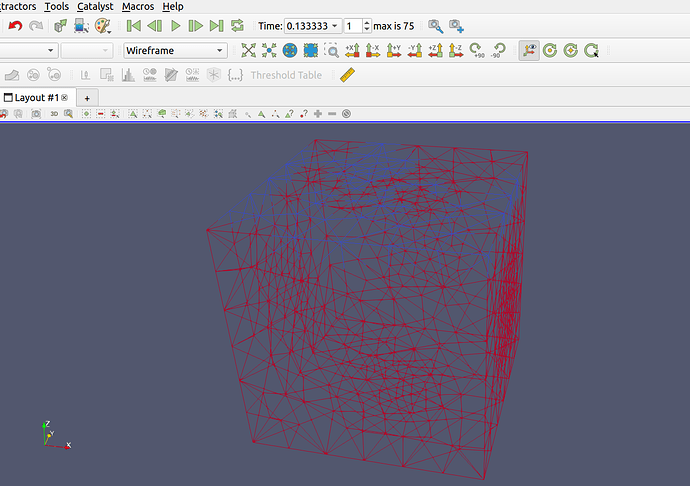

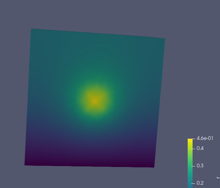

Your output is exactly what I expect to obtain. Nevertheless, I get something like this in the first step:
And I don’t have any idea of what is happening…
Taking that it worked out correctly for you, I assume that there must be something wrong with my instalation.
Thank you for your quick response.
Start by checking the scaling of your plots in paraview, what is the range?
As your initial condition is 0, paraview probably chooses the 0 to 0 range, Which you have to rescale
Oh God it was the hecking plot range… I can’t belive I’ve been stuck thinking that the simulation was wrong…
