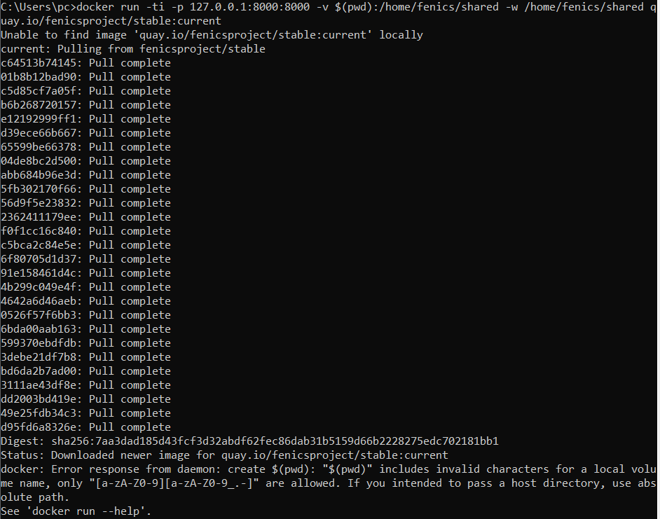

docker run -ti -p 127.0.0.1:8000:8000 -v $(pwd):/home/fenics/shared -w /home/fenics/shared Quay
I got this error
C:\Program Files\Docker\Docker\resources\bin\docker.exe: invalid reference format.
See ‘C:\Program Files\Docker\Docker\resources\bin\docker.exe run --help’.
docker: Error response from daemon: create (pwd): "(pwd)" includes invalid characters for
a local volume name, only “[a-zA-Z0-9][a-zA-Z0-9_.-]” are allowed. If you intended to pass a
host directory, use absolute path.
I can see fenicsproject/stable is stored in docker’s images.
